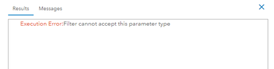

Thanks so much Johannes. I tired the code and made the necessary adjustments as you suggest but I got the error below;

MVP Alum
Huh... No idea.

AdejumoBidemi
No it generated same error

AdejumoBidemi
Thanks so much @jcarlson and @JohannesLindner . I really appreciate. The error is from AGOL and they are related. I tried the FeatureSetByRelationShipName but still generated the same error.
