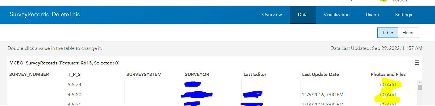

1) I have successfully loaded the data into a test Feature Layer (hosted) in ArcGIS Online from a shapefile (see below). But shapefiles do not contain attachments - I need to load it with attachments.

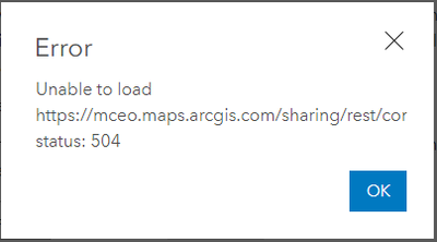

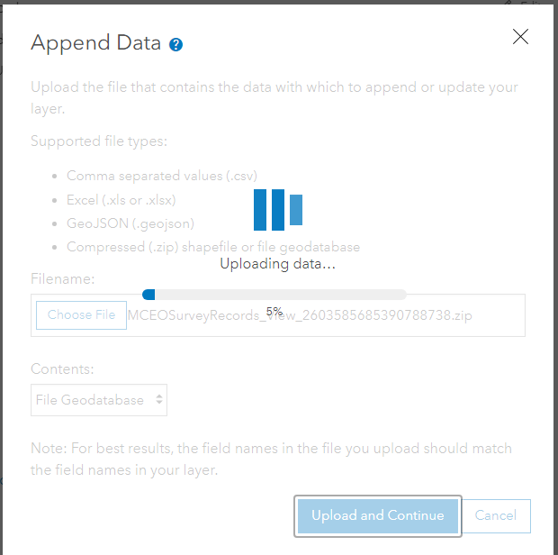

I have tried to append a FGDB of the original data (containing attachments) that was already zipped up in windows. It errors out;

I was able to figure this out. I had to move my FGDB folder off of the server before zipping it up. There was some kind of lock on it while it was on the server. After zipping up the FGDB I was able to load it, with attachments included, to a new feature layer in AGOL.
