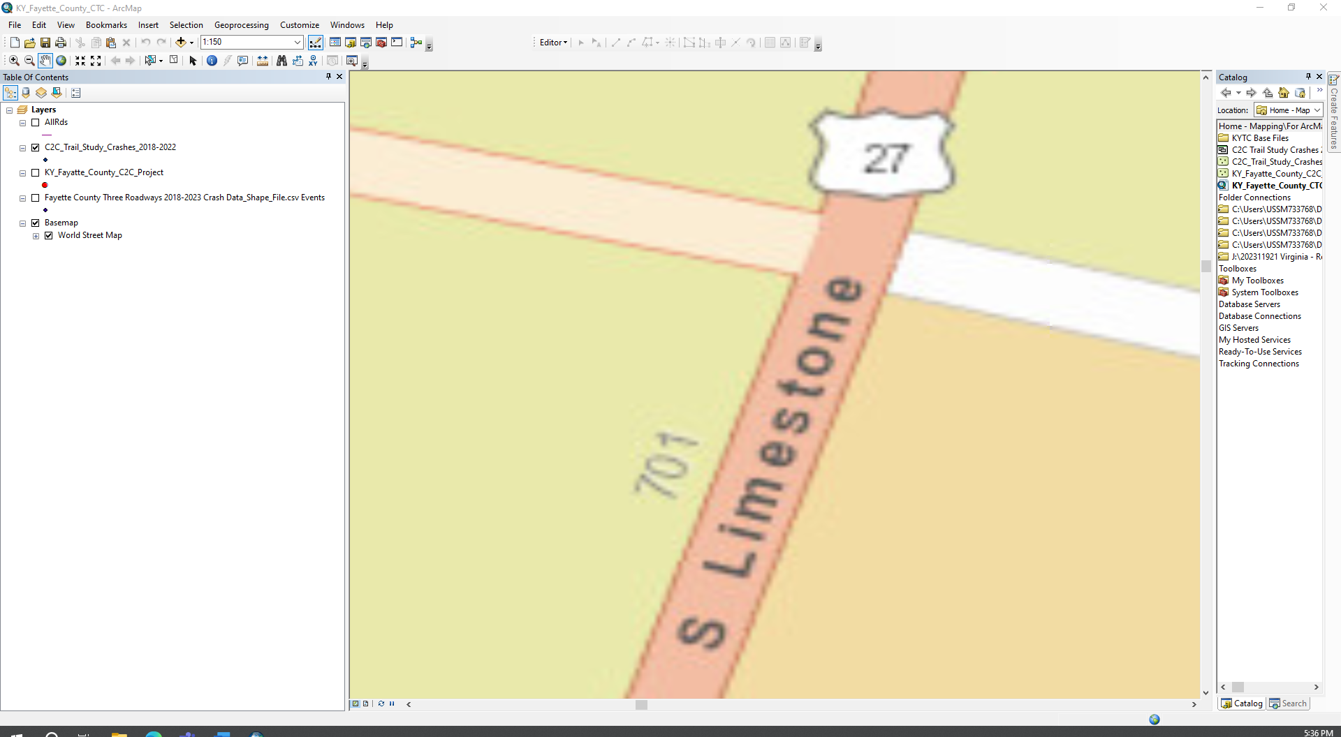

Hi All,
Thank you for your help and reading the post. I opened an ArcMap file. But opening the file, the map does not move, zoom our, in or do anything.  It hangs !!  Two days ago,  I opened the file to do some spatial analysis. From the time,  the problem started. Below is a  photo which is showing, the inactivity of ArcMap

Try renaming the normal.mxt file in your profile and seeing what happens. You'll find the file here:
C:\Users\<your account>\AppData\Roaming\ESRI\Desktop<your Arcmap Verison>\ArcMap\Templates\Normal.mxt
Rename the file to normal.old and the fire up Arcmap. It will create a new normal.mxt. Once the application is ready, try to open your MXD again. This will at least test if your Arcmap template file has gotten corrupted.
