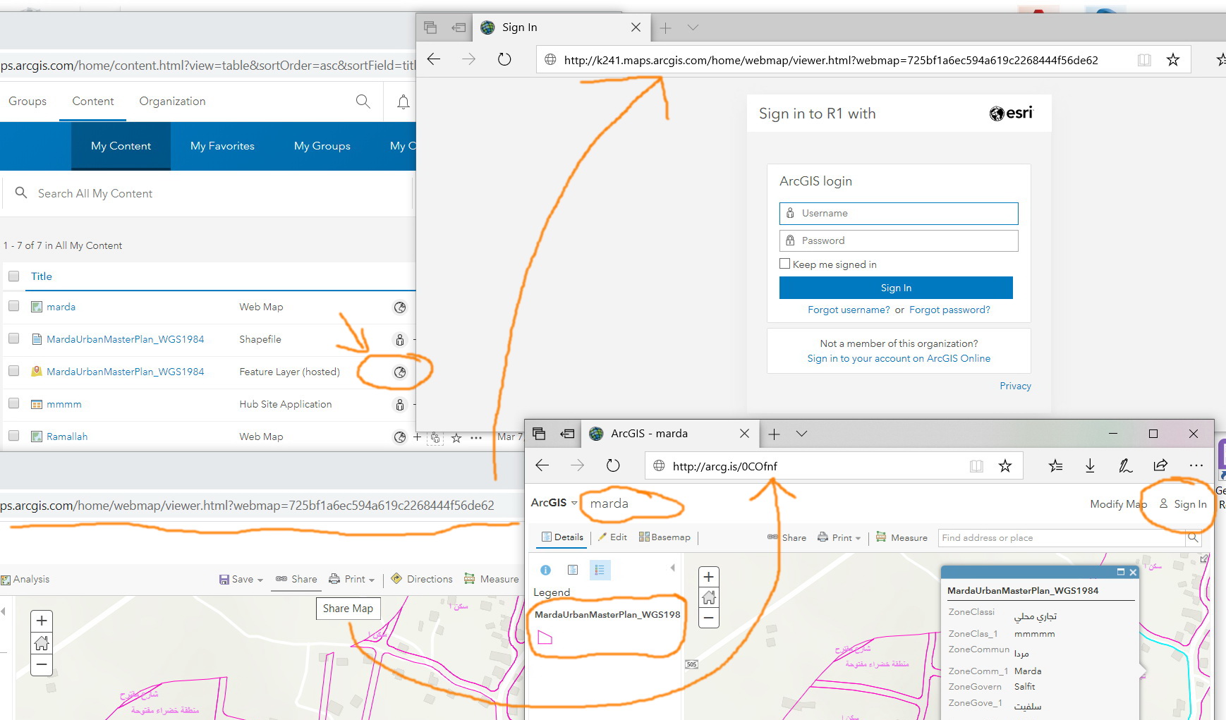

Despite the fact that the “web map” that is shared as “everyone”, it still requires logins when open with “map viewer”.
What could be the issue here?

Ah, yes you are right. I only tried the short link before. When I typed in the long URL shown in your screenshot, it asked me to login.
However, when following the short link from your screenshot (http://arcg.is/0COfnf), the browser populates with the following URL:
https://www.arcgis.com/home/webmap/viewer.html?webmap=725bf1a6ec594a619c2268444f56de62
Notice how this is different from the long URL in your other screenshot, which is:
http://k241.maps.arcgis.com/home/webmap/viewer/html?webmap=725bf1a6ec594a619c2268444f56de62
The link that asks for a login starts with "k241.maps" so it seems like it is wanting to link directly to within your organization (I think that's what's going on, anyway). The link that works just starts with "arcgis.com..."

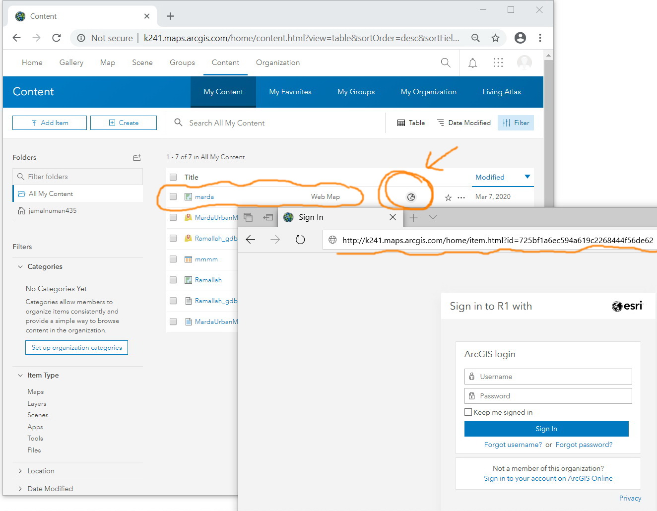

The web map includes only one layer and it is shared as “everyone”.
I observed that if the short link is used to access the web map, then no logins are required. But if the long like is used, then logins are required!
Is this by design?

Following the URL in your screenshot, I was able to view the map without needing to sign in.
I recommend trying to open the map in an Incognito Window in Chrome (or similar in a different browser) to see if the problem persists.

Precisely. This is what I have done. The ArcGIS Online is open with chrome. Both the long link and short link are open with Microsoft Edge. The long link requires logins but the short link doesn’t
Are you able to replicate the issue at your environment?

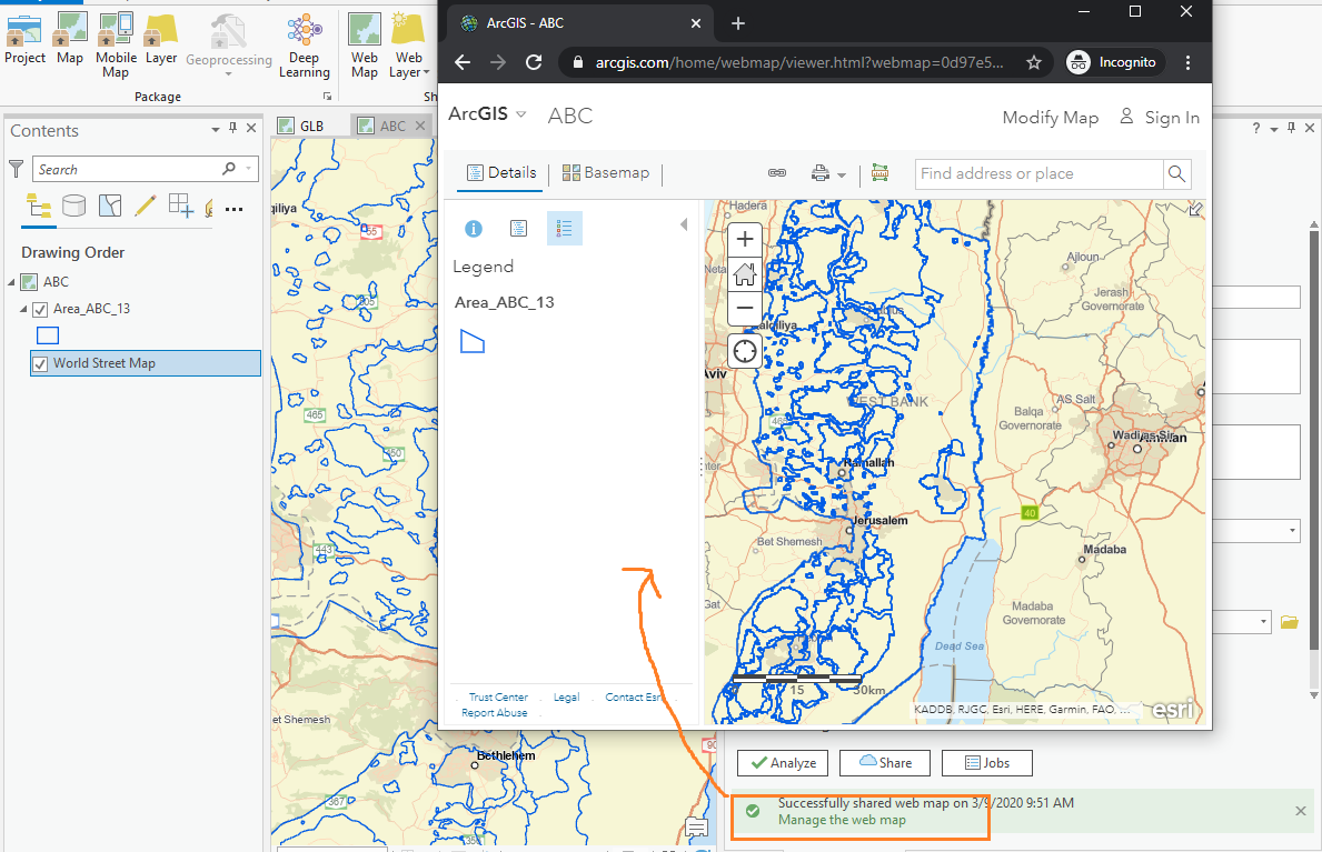

abdullahqasrawi
Dear Jamal
Try to open your map directly from the link that appears in ArcGIS Pro, Screenshot below.
