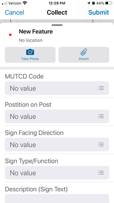

If you enable attachments on the feature class and add to a map in Field Maps, the "Take Photo" or "Attach" buttons should be there at the top for each new feature.
For existing features, you will need to select "Edit" on the feature for it to show the "Take Photo" or "Attach" buttons.
