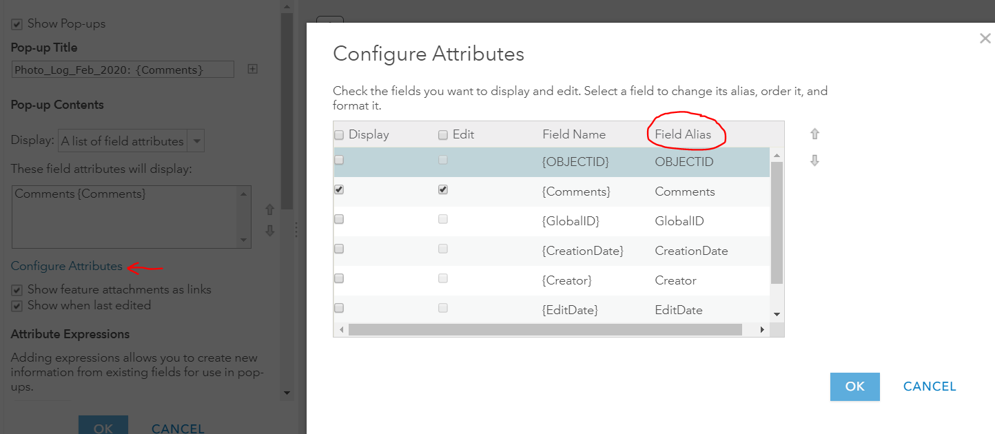

Recently, I have not been able to have ArcGIS Online retain the aliases of my pop-ups. I configure the pop-ups in Arcpro as I have always done, but when I check the pop-ups online--they are using the field name. I go to the visualization tab online and the aliases display in the pop-up. I have screen shots--this has only just happened in the last few weeks. Thanks for any assistance.
screenshots of problem

Even with the text cut off, I think I can understand what you're getting at. So the pop-up is showing correctly with field aliases used when you look at the visualization tab through the Item Details page, but not when you view the pop-up in a specific web map?

Thank you Katherine--I  have edited it  Yes, I have not been able to have ArcGIS Online retain the aliases of my pop-ups. I configure the pop-ups in Arcpro as I have always done, but when I check the pop-ups online--they are using the field name. I go to the visualization tab online and the aliases display in the pop-up just fine.  Thanks for any assistance.

That does seem a bit strange. So, after confirming that when you go to the pop-up configuration settings under visualization, it shows the correct Alias here, and the layer configurations have been saved....
Can you try adding the layer to a new web map and see if the aliases will display in the pop-up?

Yes--I've done these web maps for a couple of years and have not had this problem before. If I configure the pop-ups in Arc Pro and then share the Web Map, previously, the aliases all remained in maps' pop-ups and displayed correctly.  I would think I was doing something wrong if the visualization tab wasn't depicting it correctly. I will try to add them again --it has happened on the last 4 web maps I have shared and was wondering if it is some sort of bug
