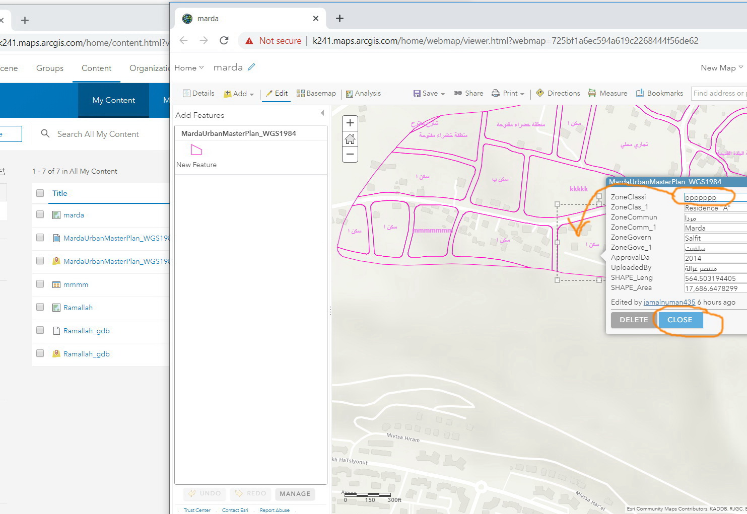

For example, in the screenshot below, I wanted to edit a feature in the indicated layer. How this can be performed?

You will need to enable editing on the hosted feature layer, which can be done in the Settings tab of the feature layer's Item Details page.
Note: In order for you to be able to implement edits in ArcGIS Online, your account needs to have editing privileges. (this is determined by user type and role)

Many thanks Katherine for the help.
I could enable editing but as editing is applied, I couldn’t figure out how to save the edits!

Once you close the pop-up, the edits should be automatically saved.

It works with me Katherine. Thank you
