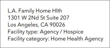

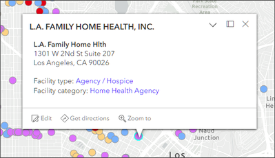

I had a couple of minutes to experiment and remembered something I had forgotten. What you get in the export, whether it is CSV or PDF, is determined by how the pop-up is configured.
Pop-up:
PDF export:

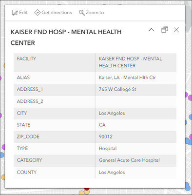

No heavy lifting at all, it's easy. Even if you do not configure your pop-up it seems to work just fine, but you should always think to configure pop-ups.

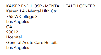

The unconfigured pop-up
The result in the PDF file:
