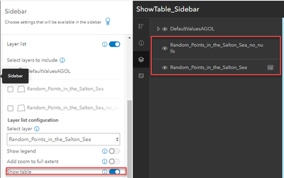

Hey @DanielHoffman73
Do your layers allow null values?
The reason I ask is that I have a web map with the same layers but one does not allow nulls and the other does:
The one that allows nulls, displays the table.

I'm having a similar issue. After enabling "Show table" under the layer list, one of my layers shows the "table" button in the app, but the other doesn't.
They are both views of hosted feature layers, with no difference in settings that I can find (either in the layer settings or in the web map). And to cmcc above - both of my layers have multiple fields that allow null values, so that doesn't seem to make a difference for me.
AMercer
Update: Today, I was able to switch layers under the "Layer list configuration" and turn on the "Show table" option for both layers that I want to show the table for. I was not able to do this successfully yesterday, so maybe something changed. Hoping it holds!
