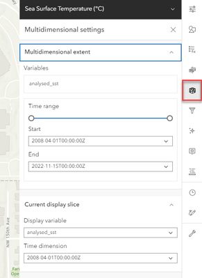

The updating of an existing imagery layer in ArcGIS Online is something that is only available currently as a dynamic image collection, but depending on the workflow, size, and the update schedule perhaps smaller .crf based imagery layers that can be deleted and replaced may work in the meantime. It all depends on the desired workflow and usage. The multidim process I described will unlock the data in map viewer to be visualized similarly to what you can with other netCDF based or other multidimensional data. If you are not as interested in using those tools like you see here.
Then the image collection with the image filtering may be desired. Feel free to reach out to discuss some more and work through your workflow.
