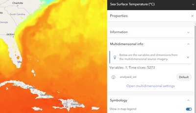

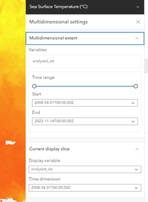

I am curious about your need of the image collection. The multidim layer in ArcGIS Online created by ArcGIS Image should work fine and allow you to access the information. If you want to see one in action, then I humbly recommend this ArcGIS Learn lesson on coral bleaching, the layer itself is located here if you want to add it to a webmap and see a tiled imagery layer with multi dim info. A dynamic image collection is not necessary to access the underlying data. When you have multi dimensional data in ArcGIS Online through ArcGIS Image, then you should be able to access the slices as you would in ArcGIS Pro.
In terms of the overwriting, I suppose this will be a 'live' layer with additional updates? Is that the case?
The multidimensional info can be accessed in map viewer.
You can select any slice in the multidimensional data.
