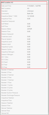

Here is a screenshot of the some of the attributes. I have over 700 fields. Each field has a prefix, in my form, indicating the specific well location. I only want to show the relevant fields for each well. So, for this well, I only want to show the attributes within the red box. I'm trying to figure out the correct expression/combination of expressions to parse down the attribute list based on the well location. Do you know of a LIKE statement or something similar that might work better than WHEN for this case?

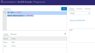

You can use this type of syntax to get fields that have multiple prefixes
var test = "LAST";
return $feature[test + 'EDITOR']
 This is using one of the profiles in the Arcade playground

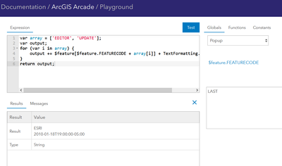

What you could do is something like this
var array = ['ArapCycles', 'ArapFlow'];
var output;
for (var i in array) {
output += $feature[$feature.wellLocation + array[i]] + TextFormatting.NewLine;
return output;
This is how it works in the Playground
