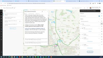

I've been using the pop-up as you'll see from the screen shot, I've managed to get the url to appear, but I'm not getting anywhere with the text. I've put the text I want in the normal 'Text' box, but then I get text no matter what.

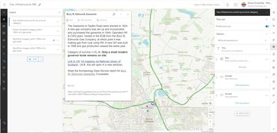

Unfortunately, it gives a null return, even when there is a url (see attached)
The upper part of text with the url comes from John's original code, the lower 'No link' from yours. I'm assuming == ' ' looks for anything not null, but this doesn't seem to have worked.
