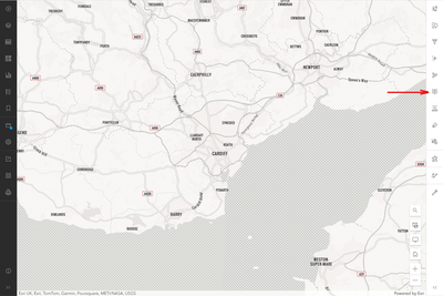

On MapViewer (not the classic one) you should have this button on right:
Click on it to see the context menu drawer
Then, at the bottom, you'll have "+ Add content" button
When you click on it, a new popup should appear, click on "Arcade"
Now a code editor should appear, put your code in it, you can try to click on "Run" to see if your code work properly
Then, click on "Finish" at the bottom right
Now you should see your text appear on the context menu each time you click on a new point
