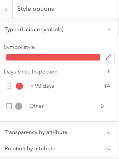

I am attempting to use Arcade to symbolize my data on a Feature Layer in the New Map Viewer. The Arcade statement appears to be working correctly, and I see the correct output symbolized when it is applied. However, once it is saved and the page is refreshed, the data is no longer symbolized and falls into the 'Other' category. If I try to move it up from the 'Other' category to symbolize and save again, I see the same behavior on refreshing the page.

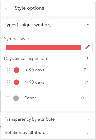

After the Arcade statement is applied to the symbology, it automatically returns all of the records under this value (which is accurate to what I am expecting to see):

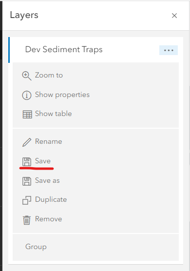

I save the map from the left side panel in the New Map Viewer (I have also tried doing this exact same thing under the visualization tab in the Feature Layer item details, which warrant the same results):

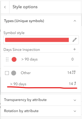

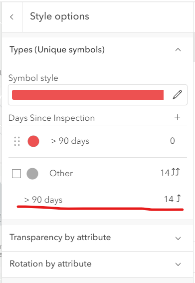

Then when I go to refresh the map, it is blank and the symbology has disappeared. Upon inspecting the symbology I see that the original value has 0 records and the same value exists under the 'Other' category now:

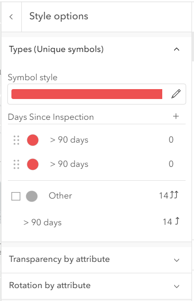

I moved the symbology up out of the other category, and the points were added to the map:
I save again, reload the map, and again it is blank. Inspecting the symbology shows the same issue has happened again:
Has anyone else encountered a similar issue? Is there a problem with my arcade statement or my method of symbolizing that might be causing this? Thanks!

Thanks this is a known issue and we are working on a fix. The angle bracket is getting sanitized out when the map is saved which causes the issue you are seeing.

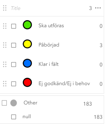

I have a similar problem, this is how my symbology is set up:
ArcGIS Pro
Expression:
Map Viewer:
Cheers
