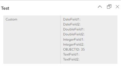

(Probably) for performance reasons, fields that are not called explicitly ($feature.FieldName / $feature["FieldName"]) are not loaded. If you want to address fields dynamically, you need the Expects() function to load them first. Luckily, you don't need to type in all the fields you want to load, you can just supply a wildcard.
This is without Expects():
var fields = Schema($feature).fields
var output = []
for (var field in $feature) {
  Push(output, field + ": " + $feature[field])
return Concatenate(output, TextFormatting.NewLine)

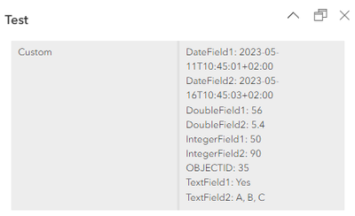

And with Expects(), it actually loads all the fields first, so it can show the values:
Expects($feature, "*")
var output = []
