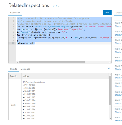

The following Arcade expression seems to be working in the Expression builder, but after saving and adding to a pop-up nothing gets displayed.
Any ideas as to what might be going on??

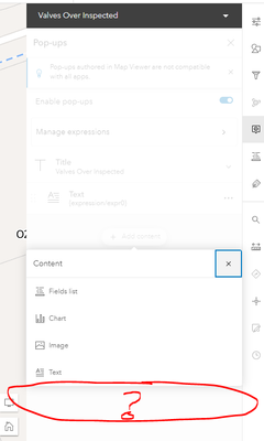

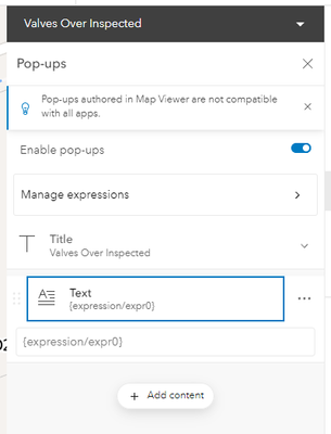

I'm also noticing that I don't even have the option to add "Arcade Expression" in my pop-up.  Is this maybe a problem with our Portal??  @JohannesLindner

What version is your Portal? The Popup element was added in Arcade v1.16, which is available in Portal 11.0. However, you don't need that as the Text element should be able to show your code properly.
Is there a chance you're using another attribute expression in your text element instead of the RelatedExpressions expression?

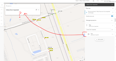

If I find that feature that is showing up when I click the "Test" button in the expression builder, still nothing shows up in the pop-up.  See screenshots below.
I really have no idea what is going on and why this isn't working.

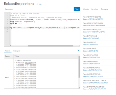

Thanks for the insight.  While all of the code works in the expression builder, it seems like all of the code in lines 4, 5 and 7 is not working.
If I do this I can get the output to say "Previous Inspection" in the map pop-up, but in the expression builder it always shows me the results I actually want.  Why would it show up differently in the expression builder than in the map?
I am using the same feature in the map that the expression builder is using.

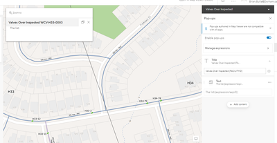

And breaking things down a bit further, even if I do this, I cannot get anything to display in the pop-up but it does display in the expression editor.
var related = FeatureSetByRelationshipName($feature, "GISWRKS1.WORKS.INSPECTIONS_Valve_Inspection");
//return "Relate"
var output = count(related) //`Previous Inspection`;
//return "var setup"
//if (count(related) != 1) output += "s";
return output
Would there be some reason why the function "Count" might cause it to crash??
