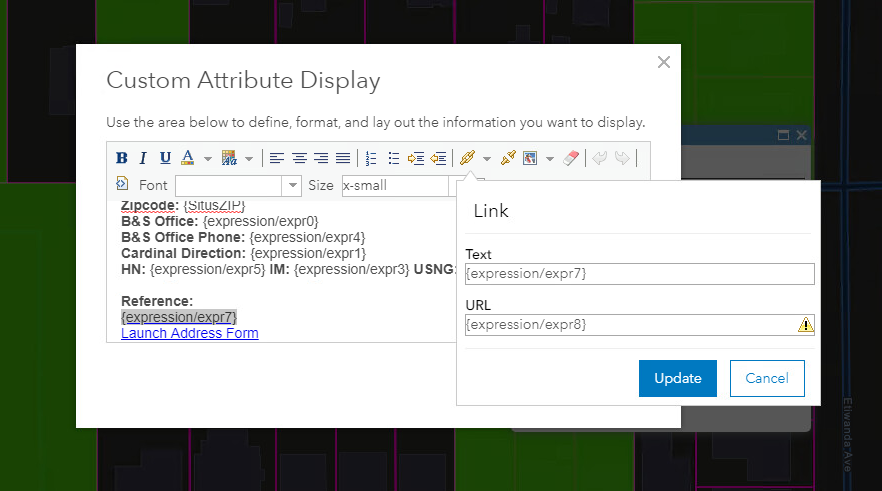

Hello Community,
I need some help with this code since I am new to coding.
I have created a custom pop-up that allows me to gather information through intersecting.
Now I wanted to get to the next level-creating links with intersecting. I created two separate arcade expressions;

Results:
The result is circled in blue, however the links both send you to the same document.
Any help would be appreciated.
Thank you.

Hi @Anonymous User ,
Thanks for clarifying!
You mention that you want to retrieve multiple hyperlinks since there can be multiple resources stacked on one another. A couple of things to keep in mind:
  • To return multiple results from a single expression, you can use the same logic as for the list of references (in each loop add a value to the result)
  • However, if a single text contains multiple URLs, it will not appear as valid URL in the pop-up
  • If each feature provides a single URL in the pop-up the fact that they are stacked does not yield any problems.
On the other hand, you mentioned earlier that you obtain the same URL for different features. I don't see a reason for this in the Arcade expression and I would first look at the data and try some different URL's manually in the browser to see what happens and that there is no redirect causing this behavior.
