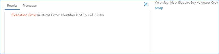

When attempting to replicate your Arcade expressions with our data we noticed the error message  “Identifier not found $view”.
We were wondering, is $view still a supported expression since we’re encountering this error?

I was able to get the same error as you when I'm in Add an Arcade Expression for the layer's popup, however it works when I'm adding an Arcade Expression under the layer's symbology, which the article shows. Is this the case for you?
Amanda__Huber
MVP Regular Contributor
Yes, thank you.  That appears to be the case, I overlooked that the expression should be added under the symbology expressions.
