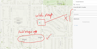

thanks for helping me on this.  I modified my expression accordingly and when I tried it in the web map.... nothing.... Then I decided to try it in the Field Maps app and it was working just fine (new record and updating existing record). I then tried to create and Experience Builder app to see how it would behave... same as web map, Empty FUID field.
Any idea why it's not working properly in the web map? For this project, my users will enter/modify data either through a web map or experience builder app.

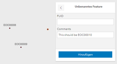

This looks as if you have not actually created the feature yet. The attribute rule doesn't  trigger when you put the point in, only when you finish the feature creation.
In the feature creation window: The FUID isn't there, because the rule didn't trigger yet.
After I clicked on "Hinzufügen" ("Add"): Now the rule did trigger, and the FUID is calculated.

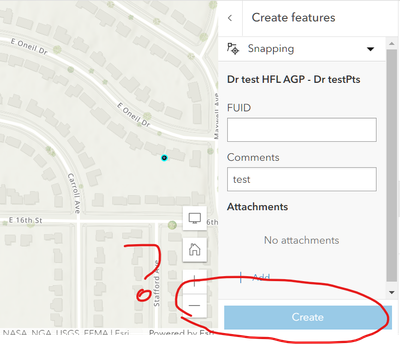

Thanks for the info. However when the expressio is enabled, I can't click the Create Feature button.

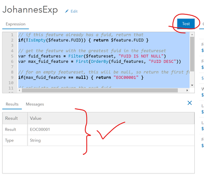

when I test the expression it seems to be working
if I disable the expresssion, then I can Create  feature
What am I missing? I also tested the process on a different HFL and different web map and same result.
