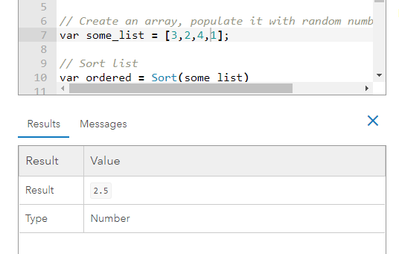

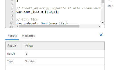

Here's what it might look like with a sample input.

Just to see that it works, here are the outputs with known "correct" values.
