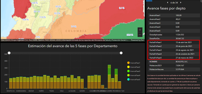

Perhaps you can get an enhanced experience using the new Arcade data expressions in Dashboard (the new one). This allows you to access any data that you have access to and transform it in a way you need. It does not apply for the map widget, but it does for most other widgets. It might be worth having a look at this capability.
Yesterday I did a little test on some local vaccination data from Colombia and did some analysis as to when a certain phase would initiate. People have been divided into 5 groups and I wanted to know when a certain group would be able to get their vaccine.
There are a lot of assumptions in the analysis but it does provide an indication and I am stunned by what one can do with this new capability:
