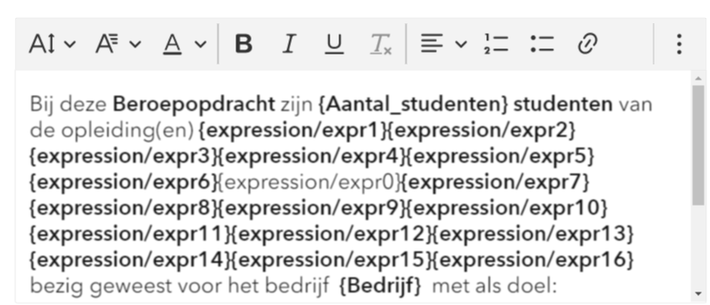

I have rows of data with abbreviations of Bachelor programs that I want to fully describe in the pop-up. Therefore I made this arcade expression for each bachelor program:
var txt = Split($feature.Opleiding, '/')
if (IndexOF(txt, 'BA') > -1) {
    return 'Bedrijfskunde en agribusiness'
Sometimes a row has multiple bachelor programs active (i.e. BA/TA). In the Pop-Up all expressions are active, see screenshot. If the program is not in the dataset, it will not be shown.
This way, both studies will show up, but without a comma or 'and'. So that is why I added this expression (expression/expr0)
if (Find('/', $feature.Opleiding, 0) > -1) {
    return ', '
However three combinations or more from these studies are also possible. Now I randomly put down the expression somewhere in the pop-up. As you might have guessed the comma sometimes will be placed before the bachelor programs or after...
The question: How could I solve this problem so the comma will be placed in between the corresponding active expressions?

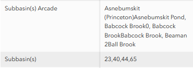

I know this is a few years old, but hoping you might be able to assist. I came across this solution and it looked like it would fit the bill for my problem, however I am experiencing a strange output and am baffled.
Problem: I have a hosted feature layer that is managed via Survey123. One of the select_multiple questions stores codes for each selected subbasin. These codes are not helpful in a pop-up, so I wanted to use Arcade to replace the code with the subbasin name.
I am not getting an error, but the returned values are incorrect when I compare the stored subbasin codes with the reported subbasin names in the pop-up.
My code is:
var basinNames = {
    '1': 'Asnebumskit (Mill St)',
    '2': 'Asnebumskit (Princeton)',
    '3': 'Asnebumskit Pond',
    '4': 'Babcock Brook',
// and so on - this is a sample of code list, which contains 212 values
var splits = Split($feature.Subbasin, ',')
for(var a in splits){
  for(var k in basinNames){
        splits[a] = Replace(splits[a], k, basinNames[k])
return Concatenate(splits, ', ')
For example, one record has stored values in the Subbasin attribute field of: 23,40,44,65. These codes correspond with:
But instead, my returned value in the pop-up is:
Even in a situation where only one subbasin was selected the returned subbasin from the Arcade script is incorrect. In this example, there was only one subbasin selected so the name (from domain label) shows up for "Subbasin(s)" in bottom row (65 = this option) and you can see the incorrect name returned in the first row:
Do you have any suggestions? I will keep working on this, but if you see something please let me know!
Thank you,
Erica
jcarlson
MVP Alum
Strange! I looks like it's somehow evaluating per digit? Notice how in your longer example, you get "Babcock BrookBabcock Brook" when the value should be "44". I'm guessing 4 = "Babcock Brook" in your domain? Following that line of thought, I would guess that "Ball Brook" = 5?

erica_poisson
Ah yes! That is exactly what's happening. My select_multiple field is a string w/ length of 2. This was an exercise in bringing to region's data together - one region used numeric codes 1 to 90 and the other used two-letter abbreviations.
When I look at an example that has comma separated two-letter abbreviations, the code appears to work properly. The correct subbasin names are returned and there are no odd duplicates.
Any idea how to get around this?
Thank you!
Erica
