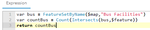

CMcDonald
I managed to get this expression to work but don't understand how the 'bus' and 'Bus' text works?!
XanderBakker
Esri Esteemed Contributor
Hi C McDonald ,
Let me try to provide some explanation on what you have created:
  • The first line assigns to variable "bus" the featureset (layer) that is accessed using the FeatureSetByName function. This function in your case will find a layer called "Bus Facilities" in your map ($map). In addition you optimize the expression by limiting the fields and not requesting the geometry.
  • The second line, has two nested functions. The Intersects will intersect the bus facilities featureset stored in variable "bus" obtained on line 1 and intersect it with the current feature (the data zone the user clicked on). This will return all the bus facilities in the current polygon. The Count function will then count the number of bus facilities found in the data zone.
  • Line 3 returns the number of bus facilities in the data zone determined on line 2.

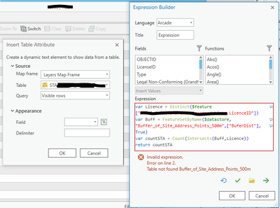

Wondering if it is possible to use this expression (or something similar) to display dynamic text in a map layout. I would like to display a count of points within a polygon in the map display. This is what I have so far but keep getting a table not found error:
var Licence =
 Distinct($feature["xxx.LicenceID"])
var Buff = FeatureSetByName($datastore, "Buffer_of_Site_Address_Points_500m",["BuferDist"], True)
var countSTA = Count(Intersects(Buff,Licence))
return countSTA
