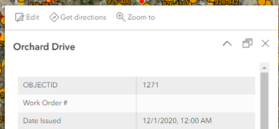

However, nothing shows up in the pop-up:

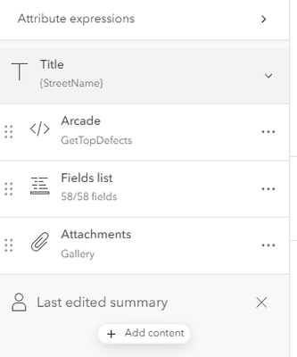

Based on my configuration, I assume the expression should be displayed above the Fields List and below the Title.  Am I implementing the expression in the pop-up incorrectly?  I can confirm that the same expression works in Field Maps and the newly implemented Forms in Map Viewer.

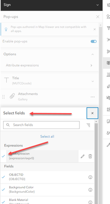

In the Fields List, Select Fields and put check box next to the expression to select it.  Then you can move it wherever you want in the popup field list.

It appears as if you used the  + Add content button in the main Pop-ups editor to add the </> Arcade Expression.
Not even sure why this is here as it seem to have no effect (as you are seeing).

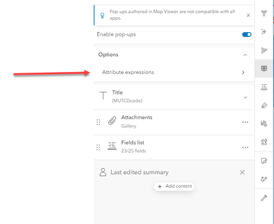

If you go to the "Attribute expressions" option and add the expression there, it will then show up in the Select Fields list and will allow you to add it to the popup.
There is also an option at the bottom of the Select fields window to + Add expression.  either method seems to work.
