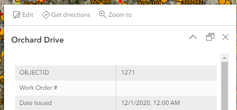

However, nothing shows up in the pop-up:
Based on my configuration, I assume the expression should be displayed above the Fields List and below the Title.  Am I implementing the expression in the pop-up incorrectly?  I can confirm that the same expression works in Field Maps and the newly implemented Forms in Map Viewer.

Thanks for the response!  I tried that, however, the expression isn't showing up in the field list:
