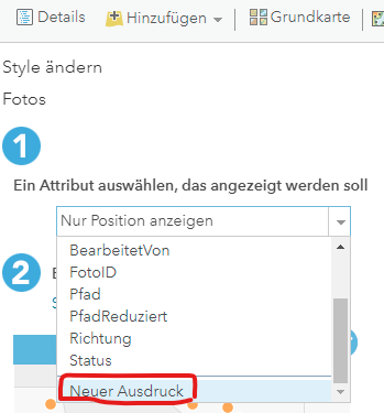

Ah. In that case:
  • go to the layer's style settings
  • Choose "New Expression" as symbol field
  • edit and use this expression (it will return true or false):

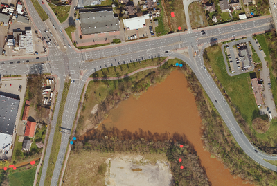

 Before:

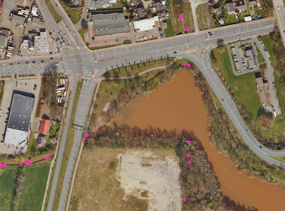

After applying the Arcade expression:

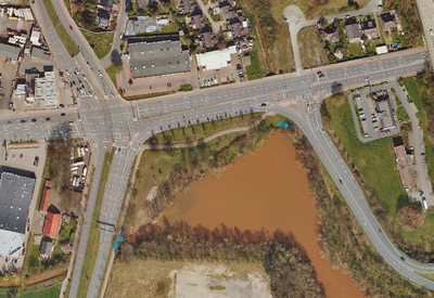

After hiding the false features:

Ah. In that case:

 Before:
