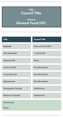

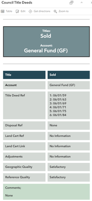

I use the following code to aggregate 6 fields into one for our Title Deeds map. I never liked seeing fields; Ref_1, Ref_2, etc etc you get the picture, that the data custodians created.
This may give you an alternative way to manage the data within the pop-up. (just an idea)
First off, this is what my pop-up looks like when a single or multiple values sit in the attribute fields, then when one or none;
JonathanMcD_0-1758145318304.pngJonathanMcD_0-1758145318304.pngJonathanMcD_1-1758145343035.pngJonathanMcD_1-1758145343035.png

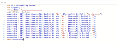

and this is what the code looks like;

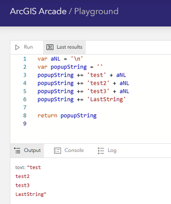

what if you set aNL = '\n'
var aNL = '\n'
var popupString = ''
popupString += 'test' + aNL
popupString += 'test2' + aNL
popupString += 'test3' + aNL
popupString += 'LastString'
return popupString

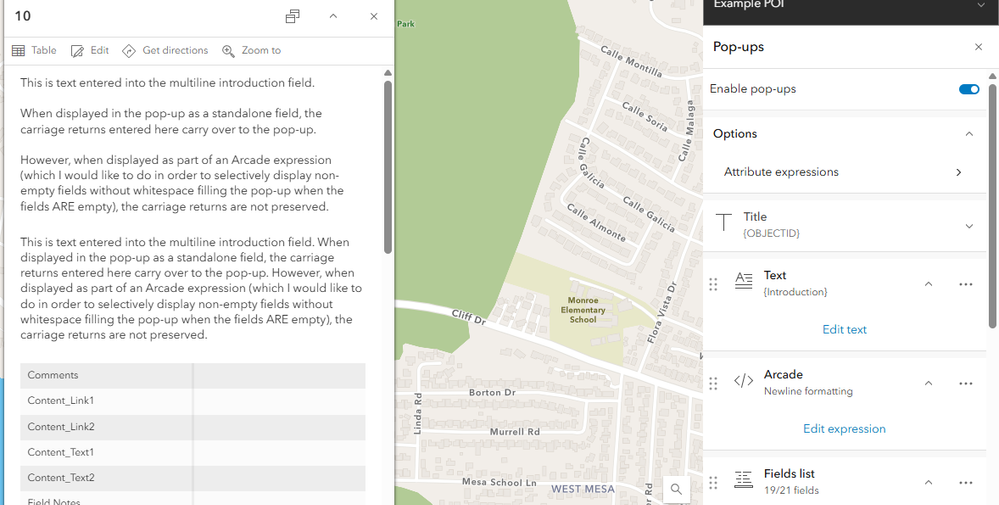

@KenBuja Adding an example of the pop-up and Arcade script below. Note that for the script I have tried a few different variations of the carriage return text to search for, and also tried using "TextFormatting.NewLine" instead of "<br />" with no change.
// Arcade expression to test newline/carriage return formatting for a single multiline text field displayed in pop-up
var raw_IntroField = $feature.Introduction;
var regexPattern = "(\r|\n|\t)";
// return {text : Find(raw_IntroField, regexPattern)}
var formatted_IntroField = Replace(raw_IntroField, regexPattern, "<br />");
return {
	type : 'text',
	text : formatted_IntroField
Text displayed from a text element vs Arcade expressionText displayed from a text element vs Arcade expression

What is the actual text in the $feature.Introduction?
JasperRomero
@KenBuja the text that appears twice in the pop-up (first with carriage returns, then without) is the exact text from the $feature.Introduction field. The pop-up configuration menu on the right is showing that the first element displaying the text in the pop-up is from a Text element that calls {Introduction}, while the second element with the text is from the Arcade Expression 'Newline formatting' which contains the code above.
