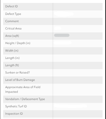

Hi everyone,
I am currently working on a project using Forms in Field Maps/Map Viewer and am a little stuck. In the Form, I have added Arcade expressions in it where if the user selects a certain Defect Type only certain fields will show up for editing. However after they submit the form, the pop-up shows every other field in the layer. Is it possible to write an arcade expression (in Map Viewer pop-up) that reads the Defect Type(11 in total) field and depending on the answer, only shows certain fields (field does not have to be filled in but if it was applicable to the defect in the form I want it to show up)? For example, If Defect Type equals Unevenness, only show the fields Area(sqft), Height/Depth(in) & Sunken or Raised in the pop-up? If Defect Type = Missing Section, only show the fields Area(sqft) & Height /Depth(in) in the pop-up.
Thanks in advance!

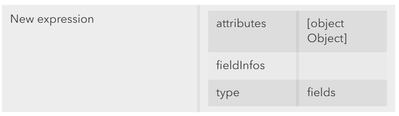

@KenBuja  I am attempting to use this functionality as well.  Within the pop-up configuration, Arcade content can be added via the "Add Content" button or it can be added as an expression within the Fields List content when selecting your desired fields.  Which location does the Arcade code go for this purpose?  When I try it directly as Arcade added content, the pop-up is blank; when I try it as a fields list expression, the pop-up shows this:
My code is a copy/paste of your original, just with my fields included.  Does it matter if the domain is used with other fields?  I have a general Yes/No domain that I'm using across many fields within the dataset.
