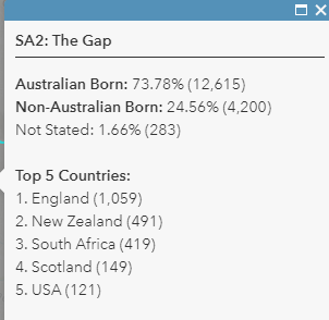

Hi Robert - I did a similar thing with Arcade (using a sample that I can't find the source of right now - apologies to the author).  I did "Top 5", you could change the first line to = 1 to just get the top one.
Below is a screenshot of the popup and the code.  The only bug / issue at the moment is that equal ranks / scores are all showing up - I would prefer it to just take the first one in that case.
Screenshots below...
Example with equal ranks:
Code below....
var numTopValues = 5;

function getValuesArray(a){
var valuesArray = []
for(var i in a){
valuesArray[i] = a[i].value;
return valuesArray;
function findAliases(top5a,fulla){
var aliases = [];
var found = "";
for(var i in top5a){
for(var k in fulla){
if(top5a[i] == fulla[k].value && Find(fulla[k].alias, found) == -1){
found += fulla[k].alias;
aliases[Count(aliases)] = {
alias: fulla[k].alias,
value: top5a[i]
return aliases;
function getTopGroups(groupsArray){
var values = getValuesArray(groupsArray);
var top5Values = IIF(Max(values) > 0, Top(Reverse(Sort(values)),numTopValues), "Insufficient Population");
var top5Aliases = findAliases(top5Values,groupsArray);
if(TypeOf(top5Values) == "String"){
return top5Values;
} else {
var content = "";
for(var i in top5Aliases){
content += (i+1) + ". " + top5Aliases[i].alias + " (" + Text(top5Aliases[i].value, "#,###") + ")";
content += IIF(i < numTopValues-1, TextFormatting.NewLine, "");
return content;
getTopGroups(groups);
