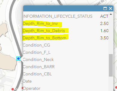

I have data collected in the field as
Depth rim to invert (A)
Depth Rim to Debris (B)
Depth Rim to Bottom (C)
I need Arcade expression for display as

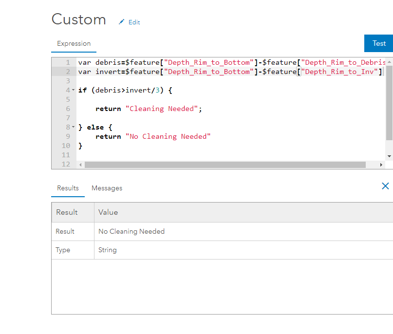

Here is my expression

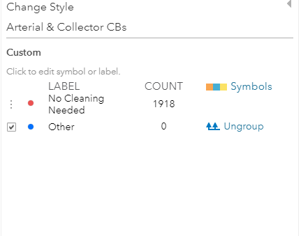

The expression Test passed but doesn’t reflect the counts in the layers as there is one data that supposed to return “Cleaning Needed”. This is reflected as 'Other' with 0 counts.
Not sure what I am missing

Hi @KhemAryal ,
If I look at your expression and the explanation it seems that you inverted debris and invert in the conditional statement.
var A = 2.50; // rim to Invert (A)
var B = 1.60; // rim to Debris (B)
var C = 3.50; // rim to Bottom (C)
var debris = C-A; // rim to Bottom (C) - rim to Debris (A)
var invert = C-B; // rim to Bottom (C) - rim to Invert (B)
Console("debris: " + debris);
Console("invert: " + invert);
// If (C-B)>(C-A)/3  'Need Cleaning'
// Else             'No Cleaning Needed'
Console("debris/3: " + debris/3);
if (invert>debris/3) {
    return 'Need Cleaning';
} else {
    return 'No Cleaning Needed';
This returns "Need Cleaning" and it writes the following to the console:
debris: 1
invert: 1.9
debris/3: 0.3333333333333333

It looks fine to me, but the logical test is obviously failing on everything and the Else is being returned.
Perhaps it's a text field rather than a float/number?  Only other suggestion is to try returning debris, invert and your logical test to debug.

I did not notice this yesterday but Its showing different than expected on the count. there are actually total of 3187 features (not 1000). and there should be 2 counts 'need cleaning', What do you think?
XanderBakker
Esri Esteemed Contributor
Hi @KhemAryal ,
The symbology is probably limited to reading 1000 features for performance reasons. Do you need the correct statistics for the entire layer?
KhemAryal
Yes I need to reflect all the features in the layer with the symbology. Otherwise I have to create more fields and individually insert domains - cleaning needed or not needed
