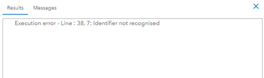

While testing this code, I received the following error. The line 38 in the error message below has been written in green color in the code above. I tried to resolve the error but unfortunately I could not. Can anyone please assist me with the solution to this error ? Thanks in advance :).

Shubhreet
Hello @RhettZufelt ,
I appreciate you taking time to look into this issue but unfortunately I receive the same error with the solution you provided. Not sure what identifier is not being recognized by Arcade and why.

Suspect because you don't declare any of the S# or T# variables until a condition is met.
Then, you are trying to compare all of them and/or add them together.  Suspect if you declare them ahead of time, error would go away.
