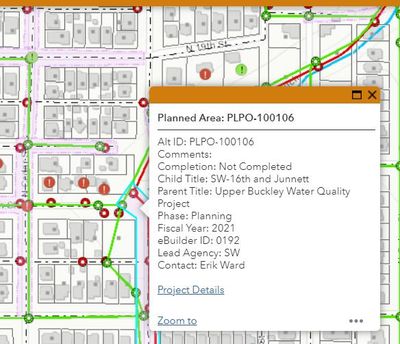

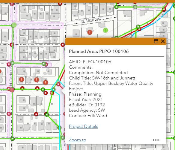

We have configured several feature image layers using Arcade in the pop-ups. The functionality works great when you are in the web map where you configure the pop-up. The problem shows up when brining the configured Feature Image Layer into a new web map. The pop-up configuration is wiped out and we lose the customization we had created.
We have tested a couple of different layers that have arcade built into them and are seeing the same results.
Here is an example of the pop-up when it is working correctly:

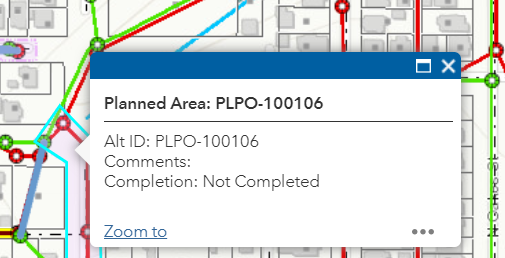

The same layer, when brought into a different map as a feature image layer:
