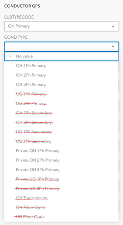

1.) The "SUBTYPECODE" will determine what filters on the next attribute drop-down.
2.) So once the selection is made on the first drop-down (SUBTYPECODE), the COND TYPE should only show related options, for example, "OH 1Ph Primary, OH 2Ph Primary, OH 3Ph Primary, Private OH 1Ph Primary, etc." and filter out the unrealted like "UG 1Ph Primary, OH 1Ph Secondary, etc."
I have two "combobox (drop-down)" attributes that I'm trying to relate to each other. If I select something in the first combobox (SUBTYPECODE) I would like it to filter out what is not related on the second combobox (COND TYPE). I've tried looking up sample expressions, but haven't found any yet. I think to achieve this would require a "if" expression? Any info would help, thank you.

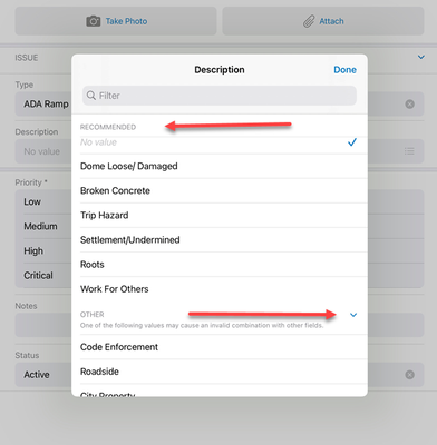

You can set these up as contingent values in Pro and publish to the hosted feature service to accomplish this.
Then, in Field Maps, when you select OH Primary, the 'related' options will show at the top as "RECOMMENDED", but the rest of the list (the red lined values) will still be available under "OTHER".
