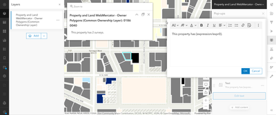

KenBuja
MVP Esteemed Contributor
This expression will show how many surveys from the table have been done at a property.
var related = FeatureSetByRelationshipName($feature, "DCGIS.SURDOCS");
var output = `${count(related)} survey`;
if (count(related) != 1) output += "s";
return output;
You can use that expression in the popup like this

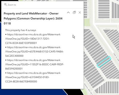

This expression will show each of the surveys' url
for (var rec in related) {
  output += `${TextFormatting.NewLine}• ${rec.FILENETLINK}`
return output;
. However, I don't think there's currently a way to make each of them clickable
JohnCoddHere
Hi @KenBuja : Thank you again for the additional expression!  This is very promising.  I do wonder what are the technical limitations specific to bringing in the full data from related tables.  I will implement the expression that you provided and let you know when it works (and accept as solution), and I will let you know if I find out how to make all the link data actual links to the image.  Thank you!!!
John Codd (Here)

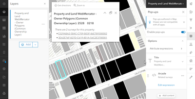

KenBuja
With some more work, I was able to get a clickable link for each related survey. This is using the popup content element. Add in an Arcade element and use this script
var relatedCount = count(related);
var output;
if (relatedCount == 0) {
  output = `<p>There are no surveys for this property.<\p>`;
} else if (relatedCount == 1) {
  var rec = First(related);
  output = `There is 1 survey for this property:
    <br>&nbsp •  <a href="${rec.FILENETLINK}">${rec.DOCGUID}</a>`;
} else {
  output = `There are ${relatedCount} surveys for this property:`;
    output += `<br>&nbsp •  <a href="${rec.FILENETLINK}">${rec.DOCGUID}</a>`;
return {
	type : 'text',
	text : output
