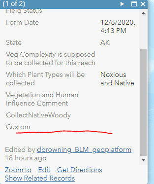

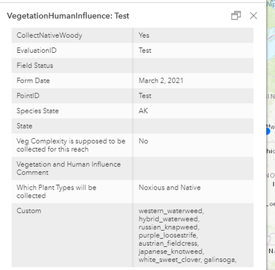

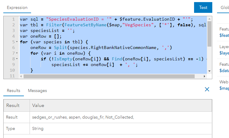

I have some Arcade code that is working in test mode but then does not work in the popup or attribute table.
Test works
Popup is blank
and attribute table gives a data error
That means my code works but there is some other issue.  ArcPro does not like it either.
Here is the code.  I am trying to create a unique list across multiple fields and repeats from a 123 form.  It is also a select multiple so the data is 1,2,3,4 etc.  That makes the code pretty messy but it does work.

After more testing it is kinda working in Pro.  It will not display on screen in a layout but when we run data driven pages it does work.
Also it is working in the pop up in Map Viewer Beta
