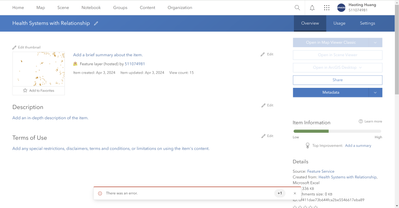

HaotingHuang
Same issue here, all the hosted feature layers not working.
