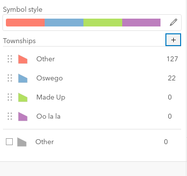

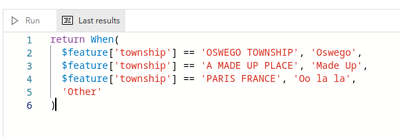

There's nothing wrong with the expression from what I can see. When you base symbology on an expression, the symbology classes will be based on values present in the data.
Here's a layer with a variety of names in it. I can define all kinds of values in the expression:

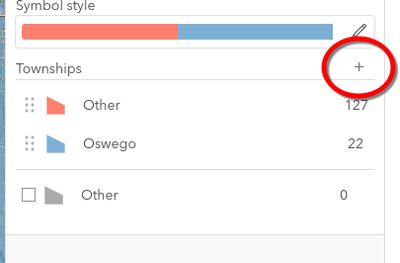

But those won't show up, because they're not in the data itself. If I wanted to add them, I need to click the plus:
jcarlson_1-1729088659602.pngjcarlson_1-1729088659602.pngjcarlson_2-1729088702108.pngjcarlson_2-1729088702108.png
