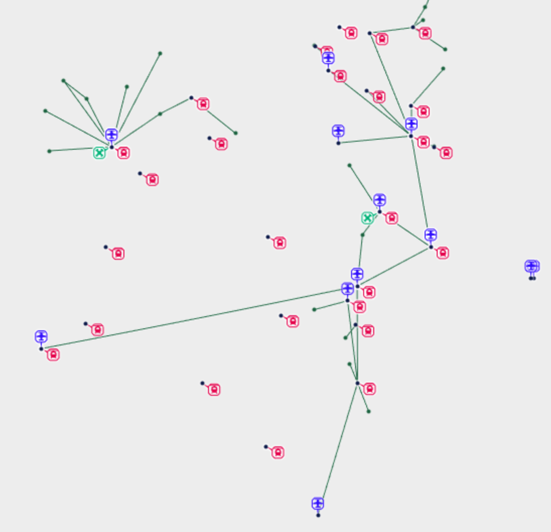

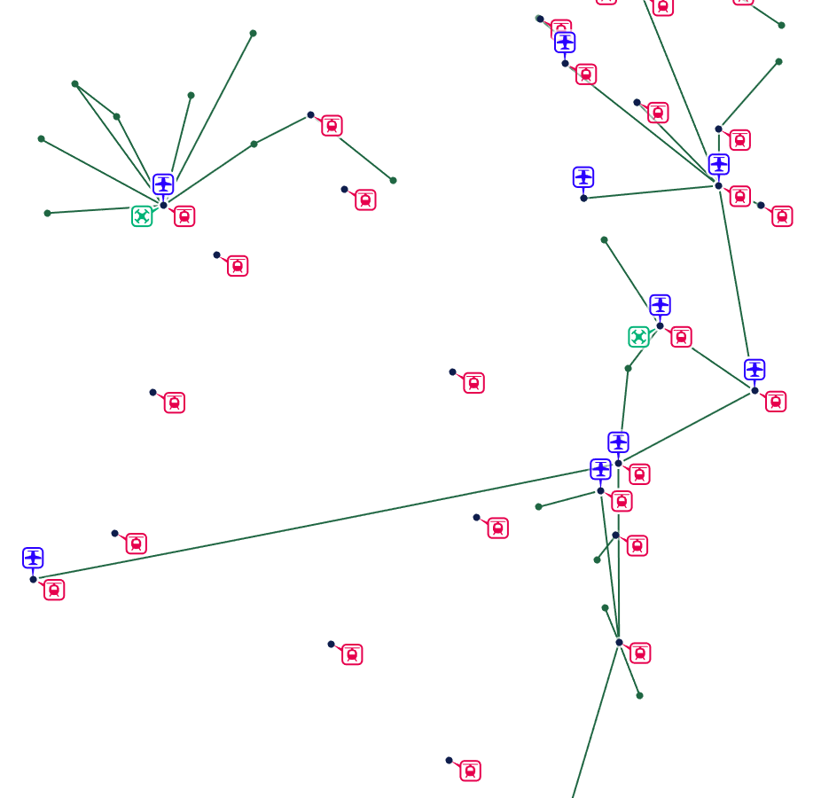

  • this is a web map I created in ArcGIS Pro, to be published as a dynamic map service
       as you can see, lines and symbols are crisp and clear even with very small details.
  • this is the same web map published on our ArcGIS Enterprise / Portal as shown in the Map viewer, but it's exactly the same in AGO or any other application that consumes the service
      Everything becomes blurry, symbol parts are realigned based on the pixel grid, antialiasing is much worse (and don't       get me started on labels).
I understand that for many use cases this might be "good enough", but in my line of work and with visualization getting more and more important for any business, I still don't understand how this is acceptable.
I recently discovered that the ArcGIS Javascript 4 renderer delivers a MUCH BETTER output that looks the same as the original, so there IS the possibility to get a quality result for our services, but so far it's locked out from the Portal/AGO platform altogether.
