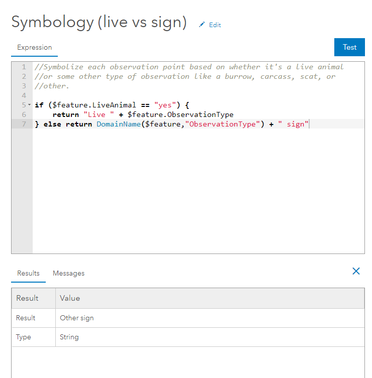

Hi all,
I have a very simple Arcade expression that is being used to create symbol categories based on two fields, ObservationType and LiveAnimal:
When tested, the result is as expected.

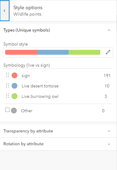

However, when I use the expression to symbolize my points, I get this:
Even the test expression from the Expression window ("Other sign") doesn't show up. They're all lumped together into a single " sign" category.
Does anyone have any idea what's going wrong?

I see this happening in a test I run using my data with domains. Can you use
} else return $feature.ObservationType + " sign";
instead of using DomainName?

HollyTorpey_LSA
@KenBuja You're right! That did it. Thank you!!
Weird, though.
