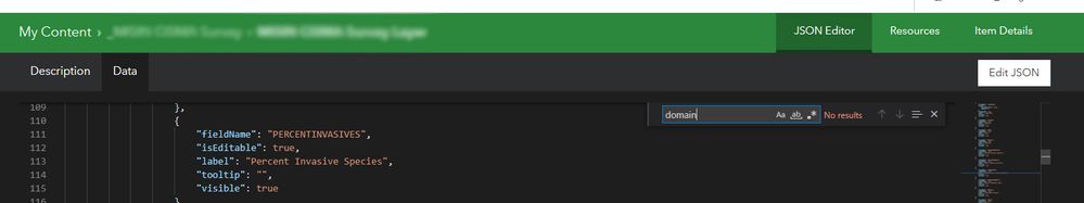

Unfortunately none of the domains show up in the Assistant
but I can see it in the ArcGIS REST Services Directory. Unfortunately, this still requires me to go through the entire tree and manually cut/paste each species into the correct order.
