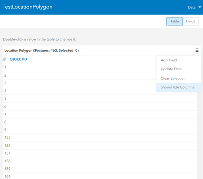

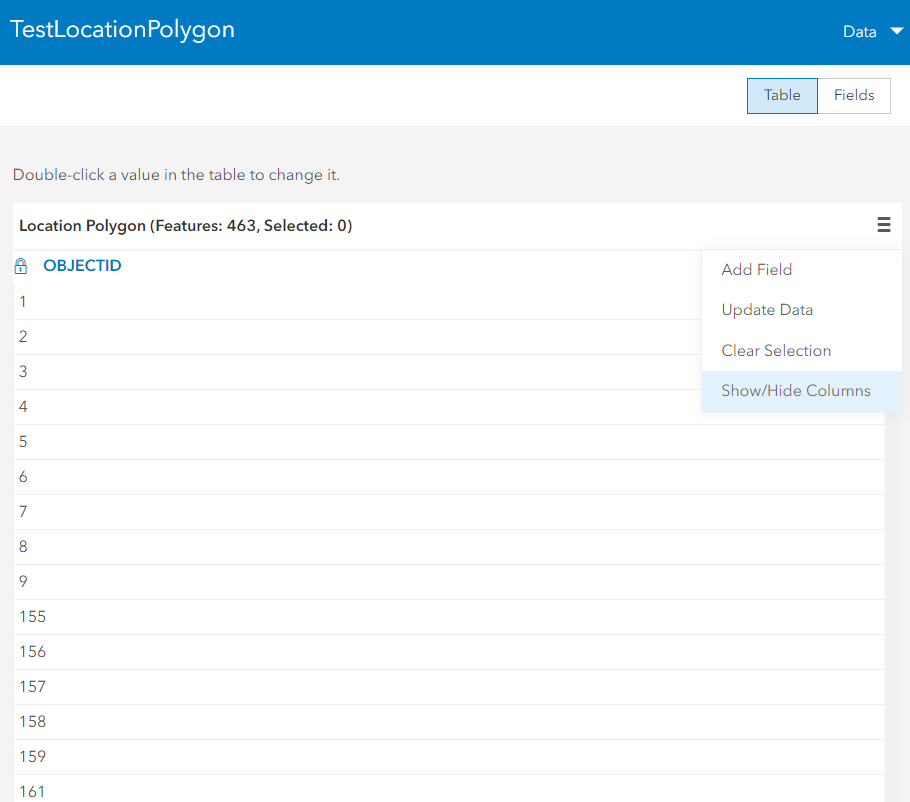

I have created a layer and Shared as web layer to ArcGIS Online.  For some reason all the Attribute Fields hidden by default.
I can manually add them back in each time.
  • How do I get my attributes to show by default?

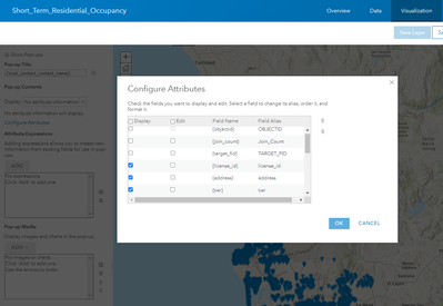

With the old Visualization tab we could easily add/remove attributes to be displayed under Data.
  • (shown from portal 10.9.1)
  • How do we add attributes in AGO currently?

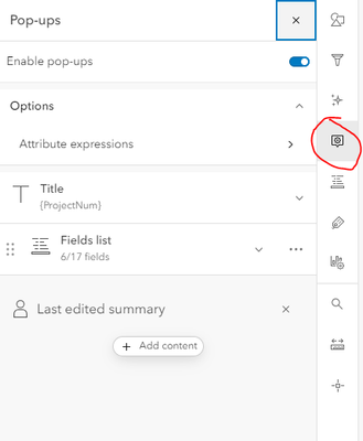

You can still adjust the attributes for popups, like in your screenshot, from the Visualization tab. After you're in the tab, select the layer from the layer list on the left side, then click the popups icon on the right side. You can adjust attribute display in the Fields List. Maybe that would affect what you're seeing under the Data tab too.
