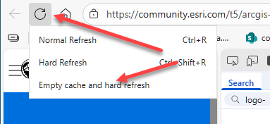

You might load the webmap in Edge, press the F12 button to enter developer mode, then right-click on the reload button and choose "Empty cache and hard refresh" and see if that makes a difference.
You can close developer mode once it starts reloading.
