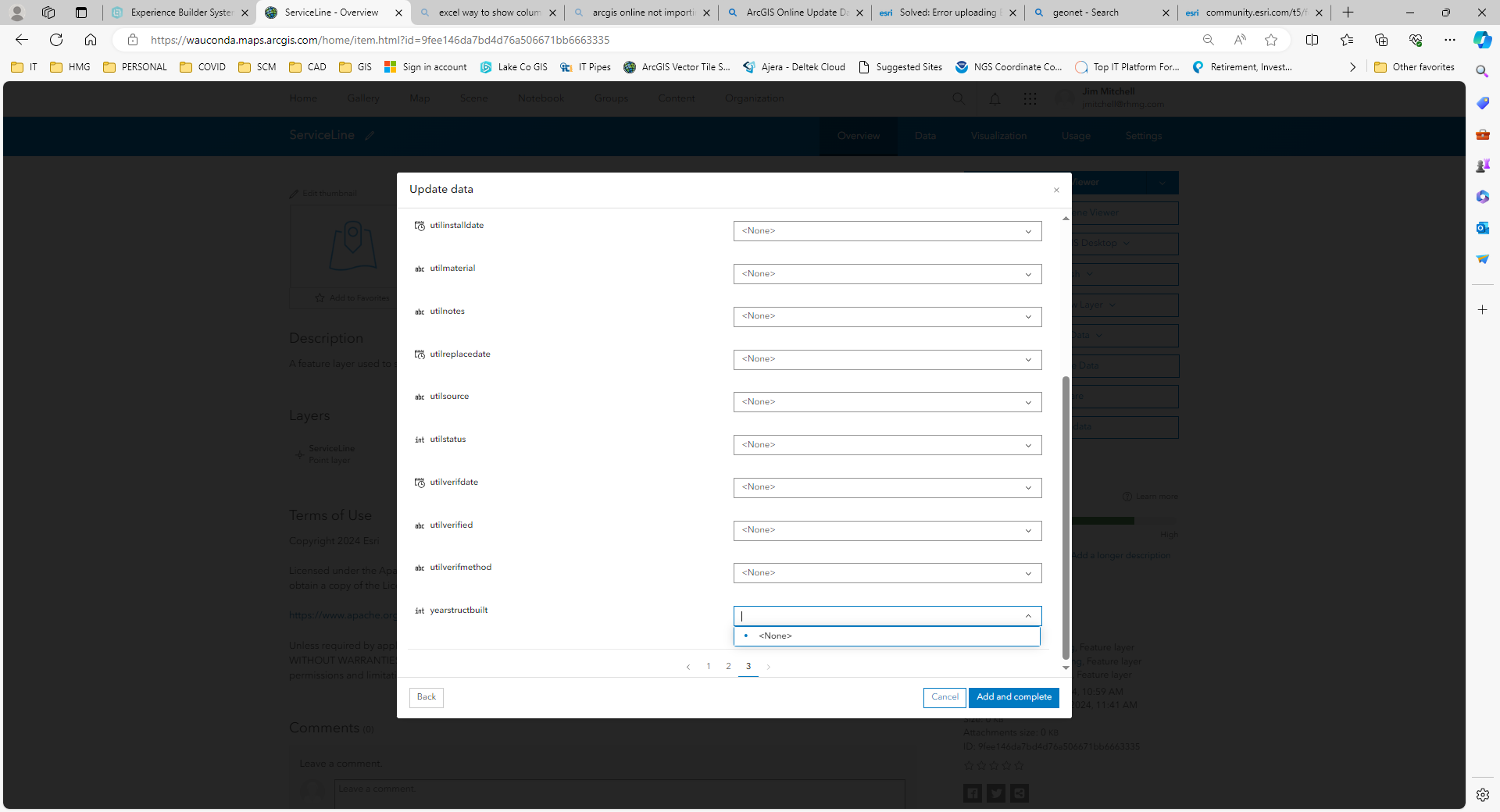

While attempting to use the Lead Service Line Inventory AGOL Solution, I attempted to import my data using the of the serviceline hosted feature class using the Update data function in AGOL. My 6000 record excel file correctly geocoded, and when attribute field matching, it recognized all of the fields from the excel file that were text.
However, the last field, yearstructbuilt, an interger field, does not recognize the last column of my excel file as integer data, it believes it is a text field and thus not able to pull that column of excel data in.

Does ESRI have a clear guide to proper formatting of excel or csv data to allow it to recognize other data formats, such as string, date, boolean, etc. It seems like the add data function is only able to recognize the data as text. I note in the field information, yearstructbuilt, it is listed as a small integer field.

CurtisMusson
I had the same issue. I used the csv to create a feature in Arc Pro. Then converted the feature to a GeoJSON. The GeoJSON preserved the integer data types.
