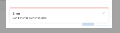

Attempting to change the ownership of a feature layer (hosted, view), but it won't let me. Is anyone else experiencing this issue?

We found that you have to transfer the view and hosted feature service together.  They can't be different owners.  We also found the transfer order matters.
1) Select the Hosted feature service
2) Select the view(s).
3) click change owner button.
We have also had this error when the Views/Feature services are shared to a private group that the new owner is not a member.

Getting this error, but there are no views.  Just the feature layer.
