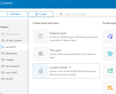

In AGOL, you can create a locator view from the ESRI World Geocoding Service.
When you create a locator view, you can define its extent in order to restrict search results to a specific area.
Once created, it is possible to share the view locator across to a Portal, but we have had instances where the view locator occasionally stopped working or sharing properly, which negatively impacted some of our public maps. Test it out, though!
