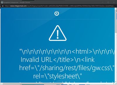

@Anonymous User I've been following along to your Dev Summit video for Hosted Feature Layer Webhooks (which is awesome, and just what I needed!), but I keep getting stuck at the same point in the process.  I'm having trouble registering the app and getting the Oauth 2 in Integromat to connect.  Following along with your example of creating an app, registering it, I get the pop up to log in with my credentials, but then I get the following blue screen error.  Any help would be much appreciated!
"\n\n\n\n\n\n\n\n<html>\n\n\n\n\n\n\n<head>\n<title>\nError: Invalid URL</title>\n<link href=\"/sharing/rest/files/gw.css\" rel=\"stylesheet\" type=\"text/css\"/>\n</head>\n\n<body>\n\n<table width=\"100%\" class=\"topTable\">\n<tr valign=\"top\">\n<td>\n<b>ArcGIS Portal Directory</b>\n\n</td>\n<td align=\"right\">\n\n</td>\n</tr>\n</table>\n\n<table class=\"navTable\" width=\"100%\"><tr><td class=\"breadcrumbs\">Error</td></tr></table>\n\n<div class=\"gwDiv\">\n\n<h3>Invalid URL</h3><br/>\n\n<b>Error: </b>400<br/><br/>\n\n\n\n</div>\n\n</body>\n\n</html>\n"
by Anonymous User
Not applicable
Glad the video is helpful! Interesting, as a test can you try registering a different app and see if you can sign into it? Invalid URL to me points to the redirect URIs specified when registering the app. There are few more listed here that I may not have covered in the video, possibly adding those would help: https://community.esri.com/t5/arcgis-quickcapture-blog/connecting-integromat-to-an-arcgis-enterprise...
If this is still not working, though not ideal you could, as a temporary workaround, generate the server token with a generateToken call and your ArcGIS Online username and password, then just use that token with the requests.

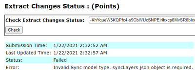

I am trying to run the extract changes for an ArcGIS Online feature layer. When I try and access the job's resulting URL I get an error stating "Invalid Sync model type. syncLayers json object is required.".
Do you know what is causing this?
Thanks, Julian.
by Anonymous User
Not applicable
Hi Julian,
The one record of this error I am seeing internally indicated it was caused by a mismatch between the layerServerGens and Layers parameters in the extractChanges call.
I would make sure the same layers are referenced in each parameter (e.g. 0 in both parameters vs. 0 in one parameter and 0 and 1 in the other). If they are and you are still running into the issue, let me know and I can help get a support case going for an analyst to take a closer look at the issue.

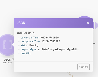

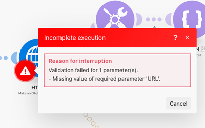

Thanks @Anonymous User , that's working a treat now with Oauth2. I'm noticing though I'm quite frequently getting the below error when trying to get the resultUrl. Any ideas to what could be causing/why it would be missing from the JSON module?
RE shameless plug, when is the tech session and how can I attend?
by Anonymous User
Not applicable

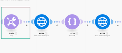

Hi @RonParis - thanks for the response on this and glad Oauth is working. I think you are running into that error because the result URL is still pending. I have run into this a few times too and needed to increase the time of Integromat's sleep tool to delay requesting the result URL:
Re: Dev Summit session - it is a pre-recorded 30 minute demo that will be made available to conference attendees. So if you register for Dev Summit, once the event begins you can view it.
