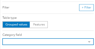

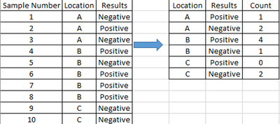

I'm working on a dashboard that will present our lab results for our samples. Basically, we have multiple samples taken at a location and then we received the results for each sample.
I need a TABLE that could summarize how many results came back as positive/negative for each location.
I know it's possible to group by 1 category but is there a way to group by 2 categories?
Thanks!

I think using a Data Expression as your source (rather than a table directly) would let you do this.  You'd want to create a derived attribute that combines the two fields you're interested in.
jcarlson
MVP Alum
Piggybacking on this: Data Expression is the way to go, and with a nicely written GroupBy function, it wouldn't be that hard.
var fs = FeatureSetByPortalItem(
  Portal('arcgis.com'),
  'itemid of layer',
  0,
  ['location', 'results'],
  false
return GroupBy(
  fs,
  {name: 'count', expression: '1', statistic: 'COUNT'}
- Josh Carlson
