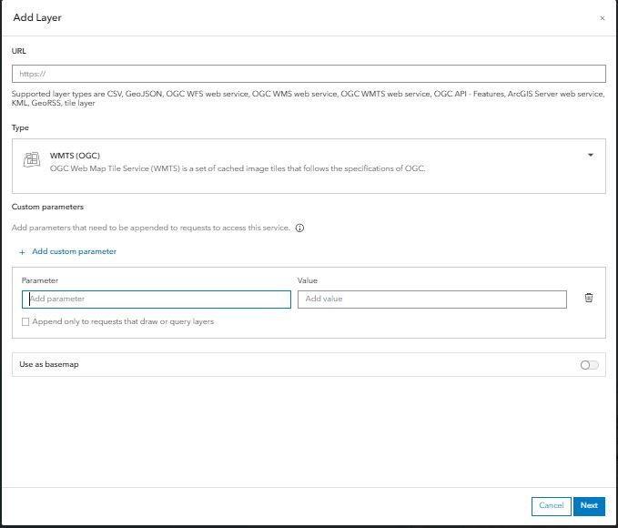

Hey Andrew,
Is there a key with the API? If so then this will need to be added as a custom parameter when using Map Viewer, rather than being included in the WMTS URL.
Hope that helps!
David
Esri UK -Technical Support Analyst
AndrewHankinson
Hi @David_McRitchie ,
Thanks for getting back to me.
There is an Project API key and a Project API secret key.
I have tried to add the WMTS API Endpoint address and then entered in both of the above as a custom parameters (seperately) and I still get 'Service does not exist or is inaccessible'
I've added a screenshot for reference.
David_McRitchie
Hey Andrew,
Thanks for getting back and showing a screenshot. The key itself should go under Value and the word "key" should go under Parameter. Top of my head I cannot remember if it matters if this is capitalised so I would try this in upper and lower case.
Hopefully that fixes things. I would also suggest deleting that screenshot as the API key could be used by other users viewing the thread. With OpenStreetMap I don't think this could be done maliciously, but it could lead to rate limiting if someone spammed requests to the service.
Hope that helps!
David
AndrewHankinson
That's got it working, thank you.
Cheers,
Andy

I am having a similar issue - would it be possible to see the original screenshot with the API key lined out?
AndrewHankinson
Here you are @KarenFergason1
