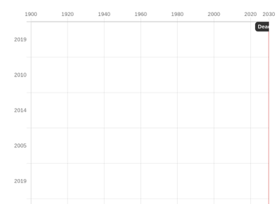

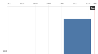

But i've a problem, if the establishment is alone (because the society have not another establishment in the world) the chart works :
but if I have 2 or more establishment, the chart do not work :
Here is my code :
